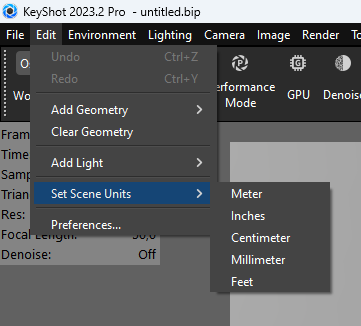

Seems like somewhere you go from imperial to metric. You can also change the units from within KeyShot
feet1
If you pick feet here and the model was in cm it will ask you if you want to Keep the Scene size or Scale Scene. The first one just changes the units you use, that does make a difference with for example objects with transperancy but not with other textures. You need the second option I think, ‘Scale Scene’. That will scale the model to the right size and the textures with them.
This will I think save you the entire Blender step in between, especially since you already have the models in KeyShot.
